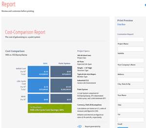

Screenshot of the LCCC
When your customer is referring to a life-cycle cost analysis, he or she is asking for an in-depth comparison of the costs associated with two similar corrosion protection systems. The life-cycle cost analysis (LCC) uses information like expected inflation rates, initial costs, project design life, and rehabilitation costs to calculate the present value of each corrosion protection system. This method is particularly suitable for determining whether a corrosion protection system with a higher initial cost will be worth it in the long run. Specifiers, in theory, will pick the system with the lowest present value when presented with this information.

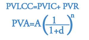

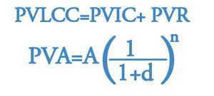

  3. Compile the data. This data will come from information on the corrosion protection systems specifically. The data needed here includes the initial costs, service life, and similar information. Compute the LCC for each alternative. Once all relevant data and values are agreed upon, specifiers will need to do the calculation for the present value of each corrosion protection system. Essentially, the present value of the initial cost (PVIC) and the present value of rehabilitation (PVR) are summed to acquire the present value of the life-cycle cost (PVLCC). And A is a single amount, d is the real discount rate, and n is the number of years from year zero. More information on the calculations and examples can be found in ASTM A1068.

Equation

Life-cycle cost comparisons are a great tool when deciding between two alternatives for a projects corrosion protection system. They are also difficult and tedious. But there is good news! The AGA has already done most of the work for you with the online LCCC tool. This tool follows the standards of ASTM A1068 and gives the present value of many corrosion protection systems with minimal inputs.
So if your customer asks for a life-cycle cost comparison for hot-dip galvanizing against a paint system, the online LCCC tool is a great resource for that information.
