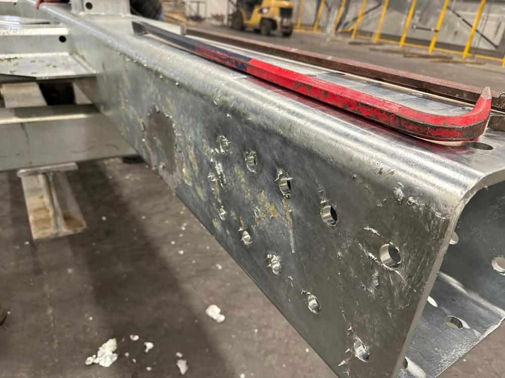

Figure 3 shows an example of the Kirkendall effect taking place on an isolated portion of small 4” square hollow section (SHS) (Figure 3). Initially, this seemed strange because the steel in the area is not especially thick and the surrounding areas do not exhibit Kirkendall effect.
Corbec5
Figure 3: Peeling attributed to a localized instance of the Kirkendall effect on the outer wall of an HSS fabrication with insufficient venting/drainage holes.

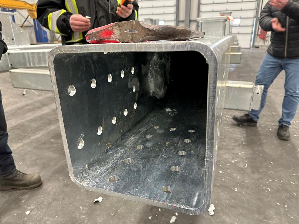

But when inspecting the internal section, a galvanizing byproduct known as dross was found frozen to the inside wall directly where the peeling occurred on the outside (Figure 4). The dross acted as insulation keeping the isolated area hot long enough for peeling to be induced by the Kirkendall Effect.
Corbec4
Figure 4: The internally frozen dross that caused the Kirkendall effect on the corresponding external wall of the SHS.
Oftentimes the reason zinc or dross freezes inside hollow items is because of improperly sized or placed vent and drain holes. This causes molten zinc and galvanizing byproducts to remain inside internal cavities and surfaces, keeping them at reaction temperature for longer than the surrounding areas. Additionally, dross is known to retain heat, often causing problematic hot spots in galvanizing kettles when not quickly removed. This time adherent dross caused a “hot spot” on the HSS fabrication, in turn causing an isolated instance of Kirkendall effect.
