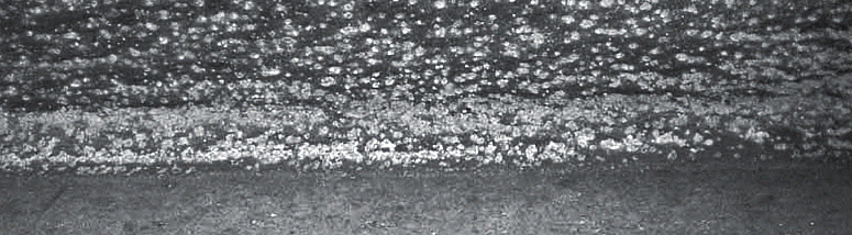

Dross adheres to newly galvanized surfaces as the steel is removed from the galvanizing kettle. The size of these inclusions determines if the galvanized product is acceptable under ASTM A 123. According to ASTM A 123, newly galvanized steel must be free from gross dross inclusions. ASTM A 123 defines gross dross inclusions as the iron-zinc intermetallics present in a galvanized coating in a form other than finely dispersed pimples. Gross dross inclusions are further defined as inclusions that would create an exposed steel spot if they were removed from the coating. the specification says gross dross inclusions are raised surfaces and can be easily knocked off through contact with lifting straps or chains, tools, fixtures, or other galvanized parts. These definitions for gross dross inclusions are what determine if a newly galvanized product is acceptable under ASTM A 123. To pass inspection, gross dross inclusions must be removed from the newly galvanized surface and the underlying steel must be repaired according to ASTM A 780. Galvanized steel with dross pimples is acceptable, because it is surrounded by zinc coating, not easily removed, and does not affect corrosion protection.

Dross Pimples
Figure 1: Galvanized steel featuring dross pimples
