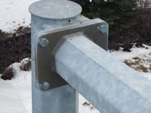

I have some older steel that may have been galvanized at one point. How can I tell?
Steel coated with a corrosion protection system may not show signs of rust for many years. If the corrosion protection system is unknown, it may be advantageous for the owner of the steel to determine. This information may determine the amount of corrosion protection left and how to proceed for future corrosion protection.
Brownstain
Brown Staining
Hot-dip galvanized steel maintains its natural matte-grey appearance for many years in atmospheric conditions. During this period, it is usually easy to tell if the steel has been hot-dip galvanized just by looking at it. Over time, however, natural weathering processes and brown staining may make it harder to determine if the steel was galvanized. Visual clues and other testing can determine which coating system was used.
Coating Thickness Measurements
Magnetic coating thickness or electronic coating thickness gauges measure the thickness of a non-ferrous coating over a ferrous surface (steel). Zinc coatings, paints, and even zinc-rich paints are all successfully measured for thickness with this type of gauge when applied over steel. The tests are non-destructive and can be done in several spots over the surface of the steel. Hot-dip galvanizers and painters use coating thickness measurements to ensure conformance to specifications.
Owners often use this method to determine if the steel has been hot-dip galvanized. Its ease of use, availability, and non-destructive nature make it the first and obvious choice to confirm the presence of a coating. Before measurements are taken, the surface should be washed of all organic contaminants and loose particles that may interfere with coating thickness measurements. If a wide range of coating thickness measurements show non-zero readings, a non-ferrous coating is present on the steel.
While this method confirms the presence of a coating, it is unable to distinguish which non-ferrous coating is present. It may be a hot-dip galvanized coating, thermal spray (metallizing), mechanically plated, or even painted.
Once coating thickness measurements determine a non-ferrous coating is indeed present, visual clues can help decide what coating is being dealt with. For example, if blisters and chips are present, the coating used is most likely a paint. If the surface has a color other than hot-dip galvanizings natural matte gray appearance, it is also likely a paint. A paint over a galvanized coating may also be possible. If the surface posses the typical traits of a weathered hot-dip galvanized coating (matte gray, uniformly weathered, possible brown staining), it may be safe to infer that it is indeed a hot-dip galvanized coating.
