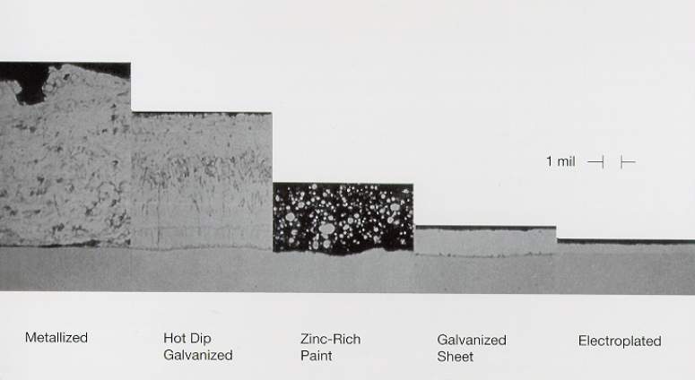

The only way to know for sure which coating is present is laboratory testing. Different forms of spectroscopy, for example, can take a sample of the coating in question and provide a breakdown of the materials present. A hot-dip galvanized coating may show a high zinc content near the outside of the coating with an increased iron content near the metal substrate. A zinc metallized or mechanically plated coating will contain a high zinc content through the entirety of the coating. A zinc-rich paint will also show a high zinc content, but will also contain other resins and binders typical to that system.
A photomicrograph of a cross-section of the coating may also be taken to determine which system has been used. A hot-dip galvanized coating will show the intermetallic layers indicative of a metallurgical bond. A metallized or mechanically plated coating will not have these layers. The figure below can be used to differentiate between these coatings.

Photomicrograph comparison of various
