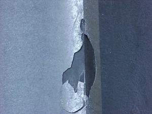

With excessive immersion times in the kettle, there is concern over the development of excessively thick and brittle coatings. The use of an excessive immersion time is especially problematic for reactive steels with high silicon/phosphorus content. For reactive steels, the alloy layers of the coating will continue to grow at a rapid rate during the immersion, while steel grades of optimal chemistry will experience a diminishing growth rate that eventually tapers off (see Figure 1).

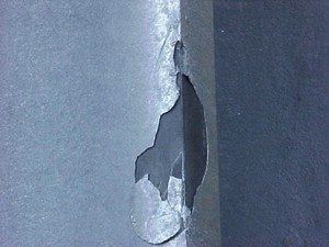

Although a thick coating is associated with a longer time to first maintenance, coatings developed beyond 8-10mils tend to be very brittle and are susceptible to flaking both at the galvanizing plant or after delivery to the job site upon exposure to impact forces during handling, transportation, or installation by the customer (see Figure 2). Such delamination issues often lead to misguided customer complaints about poor quality galvanizing.
The occurrence of flaking and repair are not the responsibility of the galvanizer after the articles have been accepted by the customer, but flaking is still undesirable. Although there are many variables beyond the galvanizers control which can make hot-dip galvanizing thick articles a challenge, there can be ways to minimize the coating overgrowth and therefore reduce the susceptibility for excessive zinc consumption and handling damage.
