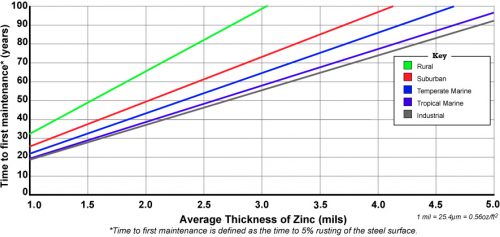

The exterior of a large storage tank will be protected by hot-dip galvanizing the same as any other atmospherically exposed galvanized steel. The corrosion rates will be predictable based on the environment of exposure and service life will span several decades. As with all hot-dip galvanized steel exposed to the atmosphere, the coating's time to first maintenance on the exterior of the storage tank can be estimated using the Time to First Maintenance Chart.
Timetofirstmaintenance
Time to first maintenance
