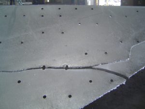

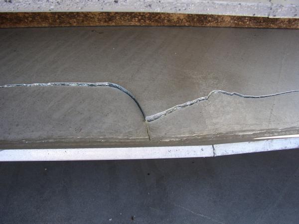

I galvanized an abrasion resistant steel, but the tensile strength was below the recommended 150 ksi. The steel became very brittle after the process. What happened?

Superior  Industries  Cracking 001
Steels like these pose potential problems to galvanizers as they may seem acceptable to hot-dip galvanize, but will become very brittle upon completion of the galvanizing process. The heat treatment the steel has already received, coupled with the thermal cycling in the zinc bath, will cause an excessive amount of strain-age embrittlement. In some cases, the steel has been reported to shatter like glass when being handled within the facility.
The pictures shown here are examples of abrasion resistant steel becoming very brittle after the galvanizing process. The received steel may have met all the chemical and mechanical recommendations tensile strength below 150 ksi, correct silicon content, etc. but was clearly not suitable for galvanizing. This is due to the hardness of the steel and from the thermal treatments it received.
So the short answer to the question: When asked to galvanize an abrasion resistant steel, walk away! Even if everything else looks right, the term abrasion resistant is a huge red flag to a galvanizer.
