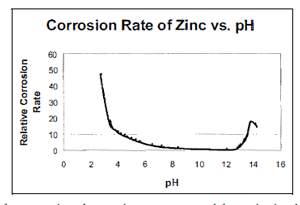

The pH of a solution identifies the concentration of hydrogen ions in the fluid. Acids, which have a low ph have a high concentration of hydrogen ions. Based or alkaline solutions have a high pH, which relates to low concentrations of hydrogen ions. The pH of a solution will dictate the solubility of other constituents in the solution. Some solids are more soluble in acidic solutions while other solids are more soluble in basic solutions. In certain cases, as with zinc oxide, species may exhibit both acidic and basic solubility. These species are called amphoteric.
After a newly galvanized part is removed from the kettle, the foundation of a protective layer on the zinc metal begins. The outer layer of free zinc reacts with oxygen in the atmosphere to produce zinc oxide. Since zinc oxides are amphoteric, this layer exhibits both acidic and basic solubility. Thus, the stable region in which zinc exhibits the least corrosive behavior is in neutral solutions.
Galvanized steel performs best in solutions with a pH in the range of 5.5 to 12. pHs between 3 and 5.5 (acidic) or 12 and 13.5 (basic) are corrosive to galvanized steel, but the galvanized coating will still give corrosion protection to bare steel, although the protection will only last for a few years. If a longer service life is desired, then a duplex system using an acid or base resistant paint or epoxy over the galvanized coating is recommended. In the figure, youll see the relative corrosion rate of galvanized steel related to the pH of its environment. For example, say you had a 4 mil thick coating; youd get about five times as much service life from this coating at pH 3.5 as you would at an approximate pH 2.5. Chemical environments with pHs below 3 or above 13.5 are not recommended for galvanized steel due to the rapid corrosion of the galvanized coating. Other corrosion protection systems that can be used in these chemical environments where galvanized steel is not recommended include stainless steel or polymers. In addition to pH, corrosion of galvanized coatings is also affected by the concentration of the acid or base in the solution, agitation, aeration, temperature, polarization and if inhibitors are used.
