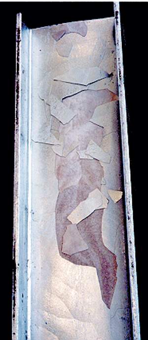

Flaking occurs when three of the four galvanized layers detach from the galvanized part. If a coating thickness measurement is taken in the area where the coating has flaked, the measurement will be near zero or even zero in some cases, indicating only the gamma layer is left on the steel. Flaking is caused by excessively thick galvanized coatings that are more brittle than coatings of a normal thickness.
As the galvanized coating grows to and exceeds 10 mils in thickness, it becomes more brittle than thinner coatings. The brittle coating can then flake off the steel when the part is struck, such as during transport or assembly in the field. Pieces of coating that have flaked off the steel usually have very long and distinct edges, as seen in the picture to the right. Because flaking of the coating causes large, nearly bare areas, it is usually cause for rejection and the steel must be repaired or regalvanized.
Some ways to reduce the galvanized coating thickness during regalvanizing include leaving it in the kettle for a shorter time period, decreasing the kettle temperature, and blast cleaning the steel. Ensuring your customers provide steel with recommended chemistry for galvanizing (see ASTM A385) goes a long way to decreasing coating thickness and thereby also reduces the chances for a coating that flakes off the steel. When you know your customer has provided you with reactive steel, blasting the steel prior to galvanizing can reduce the galvanized coating thickness that develops and thereby limits the possibility for flaking. It might also be prudent to have clauses in your purchase orders limiting your responsibility when galvanizing reactive steel that does not meet the recommended chemistry of ASTM A385.
