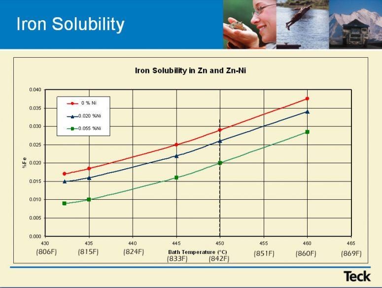

However, even if the dissolved iron content and bath temperature are kept at constant levels, dross may still be formed after an elemental addition of nickel into the bath. This is due to the fact that the presence of nickel in the galvanizing bath decreases the solubility of iron in the kettle. The chart below, courtesy of Teck Metals Ltd., shows that as the concentration of nickel is increased in the galvanizing kettle, the solubility of iron decreases at a fixed temperature.
As an example, a molten zinc bath may be completely saturated or nearly saturated (meaning the bath has dissolved nearly all the iron it is capable of) of dissolved iron at 842 F. If these conditions were held constant with no other outside factors, there would be no new dross formation as all iron would remain in solution. If, however, through an elemental or alloy addition to the kettle the nickel concentration is raised from 0.020% to 0.055%, the solubility and the total amount of iron the molten zinc bath is capable of dissolving will be decreased. The zinc bath will now be completely saturated with iron. Since there is no decrease in the total amount of iron in the bath the only option for the excess iron is to particulate and fall out of solution. When this happens, the iron particles will react with the zinc and form dross. Typically, dross formation occurring after a nickel addition tends to settle near the bottom of the kettle in the form of bottom dross.
