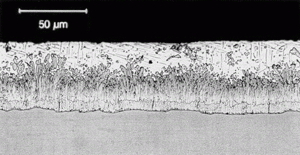

Alloy Layers
Typical zinc-iron alloy layers
The galvanizing process relies on a diffusion reaction between iron and zinc that create zinc-iron alloy layers of coating. A free zinc layer adheres to these layers as the steel is drawn from the molten zinc bath to create the typical galvanized coating. However, there are some steel chemistries that may lead to an atypical galvanized coating consisting of only the zinc-iron alloys and a matte finish. In rare occasions, coatings such as these may become excessively thick and brittle. In order to provide a typical galvanized coating with an outer free zinc layer, some care must be taken when selecting the steel to be galvanized with attention to the steel chemistry. The guidelines below will assist in the steel selection process. Steel with chemistries outside these boundaries are considered reactive steels and may form the atypical coating discussed above. When deciding if the steel chemistry falls within these suggested limits, keep in mind the mill test report you are given may not be 100% accurate.
