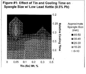

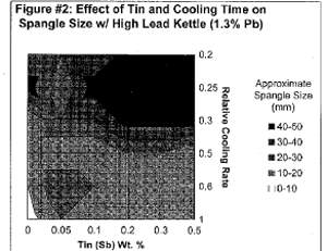

Let's first begin by defining "spangle." Spangle is the appearance of tiny triangular and/ or flower~shaped crystals on the outer surface of the galvanized coating. Often times they are referred to as "flowers of zinc." Now, isn't that pretty? Architects and engineers who appreciate the aesthetic value of the galvanized coating frequently desire this spangled appearance. This coating phenomenon is a combined product of multiple variables; however, it can ultimately be controlled by adjusting bath chemistry and cooling time. The presence of spangle on the galvanized coating is the result of minor bath additions forming alloy crystals with zinc. Elements that alloy with zinc to produce spangle include lead, tin, aluminum, cadmium, antimony, copper and a variety of others. The most common bath components are Zn-Pb-Sn or Zn-Al-Pb. The size and type of spangle are greatly affected by the concentrations of the two alloying elements and rate at which the article is cooled. Figure l & 2 are charts that approximate the size of spangle that will be produced from varying bath compositions and cooling rates for a Zn-Pb-Sn kettle. A general trend that is clearly evident from the two charts is that the largest (and most defined) spangles are produced from the slowest possible cooling times and higher amounts of the minor alloying element (in this case tin).

Figure #1: Effect of Tin and Cooling Time on Spangle Size with Low Lead Kettle (0.5% Pb)
The largest crystals, or spangle, are formed on smooth surfaces with a thin layer of Zi1"lC. Sufficient time for crystal growth is also required. Quenching articles after galvanizing will cool the zinc coating to a level below that at which crystals form and the appearance of spangle will be significantly decreased if any is present at all. When galvanizing reactive steels, the intermetallic layers will consume all of the shiny, free zinc available to create spangle, resulting in a dark, matte gray, Zn-Fe alloy coating. Thus, aesthetically pleasing spangle cannot be produced on reactive steels, unless the rapid coating growth is controlled by the bath additions.

Figure #2: Effect of Tin and Cooling Time on Spangle Size with High Lead Kettle (1.3% Pb)
