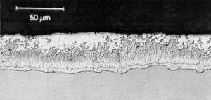

Figure 1
The low-silicon steel (less than 0.04%) creates a zinc coating that is limited by the interdiffusion of iron and zinc. However, the thickness can be controlled by blast cleaning the steel prior to galvanizing. The blast cleaning of the steel causes a very rough base steel surface creating an easier diffusion path for the iron and zinc to mix. This allows the zinc coating to become much thicker than normal. See Figure 1 above for a microstructure of hot-dip galvanized low silicon steel.

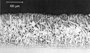

Figure 2
High-silicon steel can naturally create a very heavy and thick zinc coating when it is hot-dip galvanized. However, the thickness can be controlled by blast cleaning the steel prior to galvanizing. Blast cleaning the steel causes the zeta layer of the coating to become very rough, with numerous peaks and valleys in it. These peaks and valleys actually interfere with the zinc coating growth and can be seen in the microstructure of hot-dip galvanized high silicon steel in Figure 2. This interference during the hot-dip galvanizing process keeps the zinc coating from growing at an accelerated rate. The final coating thickness after blasting is then much lower than the coating thickness would be without blasting.
Even by using a blast cleaning technique to control the zinc coating thickness of galvanized products, the recommended silicon composition for steel is either less than 0.04%, or between 0.15% and 0.25%, in order to achieve normal coating thickness.
