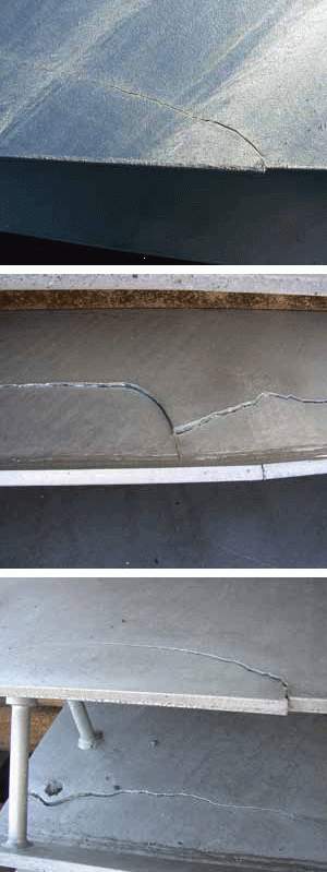

AR400 steel is not recommended for galvanizing. Residual stresses from the steel being cut or bent may cause cracking during the galvanizing process as seen above/below.
AR400 stands for abrasion resistant with a minimum hardness on the Brinell scale of 360 and a nominal hardness of 400. Typical uses of AR steel, which is classified as a carbon steel, include chutes for gravel or coal in mining, liners for heavy equipment, and rifle range silhouette targets. AR steels are not intended for structural purposes and have a tensile strength in the range of 180 200 ksi.
Steels in this tensile range have a very small grain structure, which during the chemical cleaning portion of the hot-dip galvanizing process can trap hydrogen within that grain structure, ultimately leading to hydrogen embrittlement of the steel when it has external forces applied to it, i.e. during use. However, unique to AR steel which is quenched and tempered to reach the high hardness level, it will likely crack before being put into service, i.e. during the galvanizing process, due to residual stress in and around areas where the steel was cut, bent, welded, or drilled. This is technically not hydrogen embrittlement. There is no ASTM specification for AR steel, and it is produced by a number of steel manufacturers under a variety of trade names such as Algoma 400 and Hardox.
