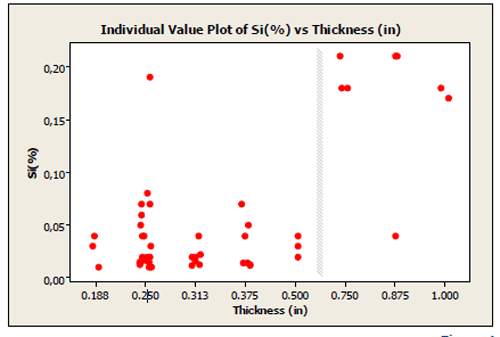

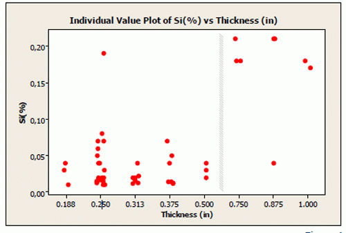

Figure 1
This study by Corbec was critical to recent changes made to ASTM A123/A123M for the two different material categories, Structural Shapes and Plate and Strip and Bar, for steel thicknesses ranging from >3/16 inch to <1/4 inch. The changes reduced the minimum coating thickness requirements from 85 microns (3.4 mils) to 75 microns (3.0 mils). The need for the change in coating thickness requirements is demonstrated in Figure 1. This chart shows for plain carbon steel thinner than 1/2 inch, the silicon level tends to be low (often less than 0.05%). For these types of steels, aluminum is often used as the primary oxidizer. Because aluminum is the primary oxidizer in these steels, the silicon level will be low in these steels and the galvanized coating thickness tends to be thinner as well; so low in fact it is often difficult or impossible to meet the previous coating thickness requirement of 85 microns (3.4 mils).
