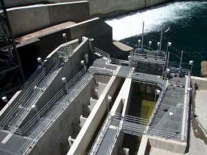

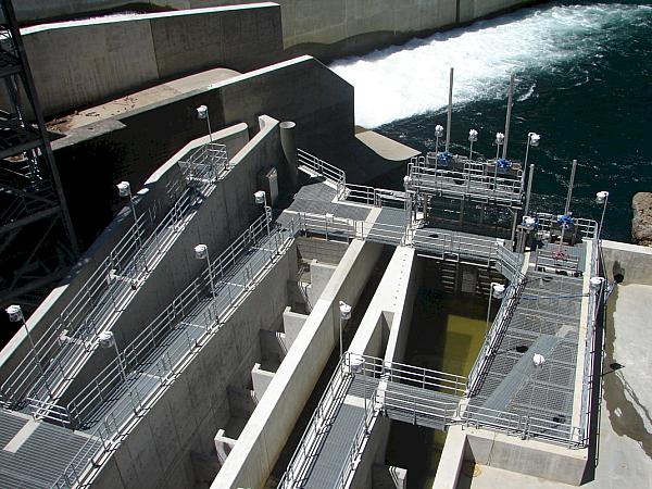

1356716609  Soda  Springs 5
Soda Springs
