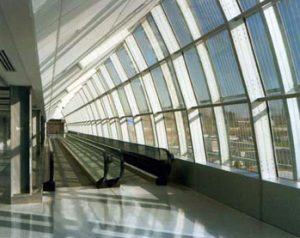

Structural Steel
To achieve a striking facility capable of drawing higher traffic, structural steel framing can be bent and arched into striking shapes, and galvanized steel can protect these attractive elements from corrosion. The Charlotte Douglas International Airport Parking Garage Terminal features a unique convex exterior façade reminiscent of the curvature of an airplane wing. A steel framed structure also allows the possibility of incorporating skylights and ceiling windows to create an open space and interior filled with natural lighting. These aesthetic advantages can create a facility that will be soothing to anxious travelers and make the airport stand out architecturally. Galvanized steel will protect the exposed portion of these structural elements from deterioration due to rust or corrosion. This will keep the structure safe and attractive for generations of travelers to admire.

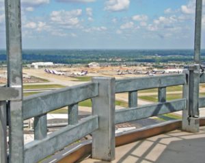

Memphis Traffic Control
Sitting aboard a plane, high above the tarmac, you may not realize, but steel is all around in the ground below. Within the concrete in the surrounding air ramp, or "apron", taxiways, runways, or air tower controls, reinforcing steel is often used to increase the tensile strength of the concrete. Moving around the apron, the Ground Support Equipment (GSE) includes moveable stairways for ground deplaning; baggage chutes; luggage trolleys, vehicles and pallets; food and beverage catering lifts, and more are critical to maintaining smooth traffic flow at any airport. Finally, jetways connect the airfield to the terminals, and are often a visual indicator of the state of upkeep and maintenance at an airport. Galvanized steel can keep these elements looking attractive and functioning properly, corrosion-free. Exposed structures such as jet bridges, moveable stairways and chutes, and other ground boarding equipment such as ramps or railings are investments that also need protection from deterioration. Utilizing hot-dip galvanized steel for these structures will provide the maintenance-free durability, seismic resistance, and corrosion protection necessary to keep airport operations running smoothly. At a distance, air control towers stand tall, directing traffic to and from the airport. These parapets, often made of concrete, are also supported by reinforcing steel, and can even be made entirely out of structural steel for a more modern, appealing look. Galvanized steel provides several benefits to these structures.

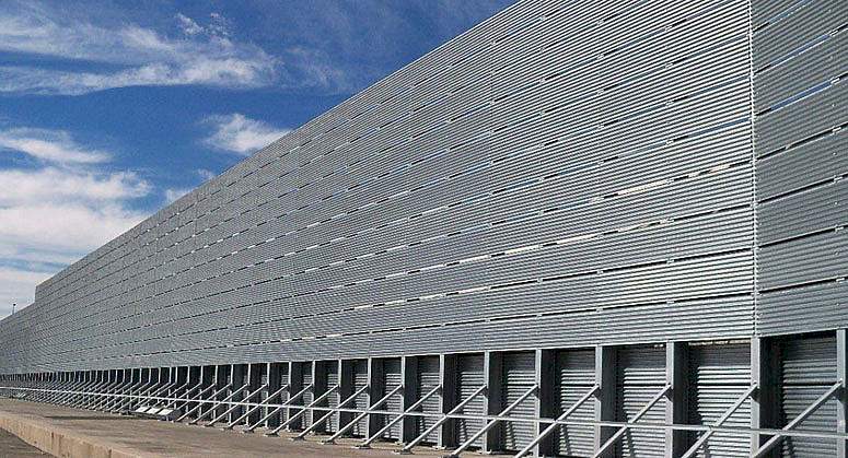

Blast Deflectors, Inc.- JFK International Airport
JFK Blast Deflectors
Blast Deflectors, Incorporated (BDI) is one of a few manufacturers of jet blast deflectors in the world. They recently designed and installed their biggest and most durable deflectors to date at John F. Kennedy International Airport in New York City, and hot-dip galvanizing (HDG) was specified as the protective coating. Located just minutes from Manhattan, JFK Airport services nearly 25 million airline passengers annually and is one of the busiest airports in the country. The height of the blast deflector extends above the adjacent parking structure, making it highly visible to travelers and airport personnel. HDG ensures that the deflector's appearance as well as its functionality and structural integrity will be preserved for many years.
