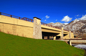

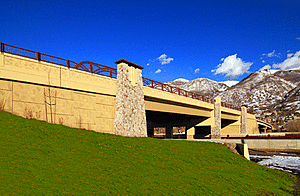

Mechanically stabilized earth (MSE) is a structural system used throughout our infrastructure for earth retention and load support. MSE systems are utilized to meet a variety of infrastructure needs, including highway retaining walls, bridge abutments, ramps, and overpasses as well as structures for railroads, mass transit, airports, and commercial and industrial facilities.

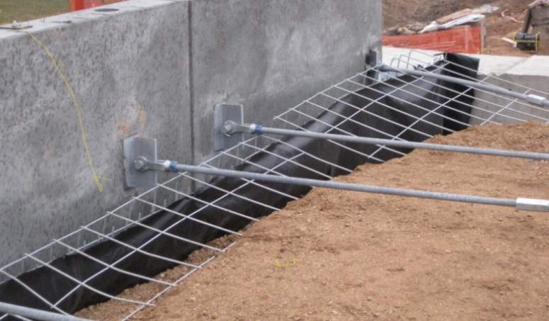

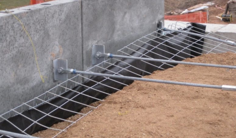

Mechanically stabilized earth structures typically have three main elements:
  • Facing: The vertical façade or wall element; most commonly constructed of interlocking precast concrete panels with standard or custom-designed architectural finishes. In addition to its architectural features, facing prevents localized erosion and has embedded connectors for attaching the reinforcements.
  • Reinforcements: These extend from the facing into the backfill for a distance related to wall height and structural loading, but at least 70% of the wall height. The reinforcements are flat, ribbed steel strips, welded wire mats, or bar mats, typically hot-dip galvanized after fabrication. Friction between reinforcements and backfill binds everything into a strong stable mass.
  • Backfill: The soil which forms the bulk of the MSE structure. Its properties are specified not only to provide strength, but also to minimize corrosion of the reinforcements. Backfill is placed in lifts, alternating with facing panels and reinforcements, until the structure's required height is reached.

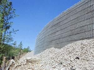

US 41 Retaining Wall- Fox Valley, WI; 2011
Logistics and material handling were key to the success of the US 41 Retaining Wall project. The wall design called for long wire wall panels. As you can expect, long panels such as these are difficult to handle and subject to bending. On top of that, the panels and backing mats needed to be choreographed to reach the job site in precise order; construction crews do not wait for anyone and any delay or mis-shipment can bring a project to a halt causing enormous back charges. The turn around times provided by the HDG process were critical. Close communication between the designer, fabricator, truck lines and galvanizer was necessary to accomplish the effective execution of the plan.
Similar to HDG steel rebar, HDG welded wire for retaining walls proves the economic value to the tax payer. As our infrastructure shows rapid decay, the taxpayers want longer solutions with no environmental impact. HDG is a perfect fit. Projects such as this one are perfect examples of the cost effective, flexible, environmentally safe benefits of HDG.
