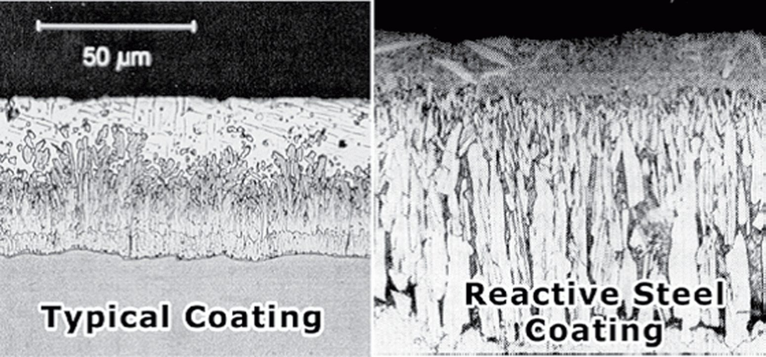

Intermetallic Layer Growth
The galvanizing reaction is a diffusion process with the layers of the coating growing perpendicularly outward from the base steel. Compared to steel with recommended chemistry for galvanizing, the intermetallic layers of reactive steel grow in long, pronounced and jagged columns as shown above. Blasting interferes with the growth of the zeta intermetallic layer of the coating.
Blasting Reactive Steel
Blasting is a process whereby abrasive particles are propelled at the steel surface using compressed air. Blasting can be done to remove paint, varnish, or sand from castings, substitute acid chemical cleaning, remove weld residues, or remove rust or mill scale from steel. Blasting can also be done on reactive steel to limit coating growth during galvanizing. Blasting roughens the surface of steel and in so doing interferes with the growth of the zeta intermetallic layer. Rather than growing in long columns when the surface is flat, blasting creates many peaks and valleys so the crystals collide and interfere with each other to the point they cannot continue growing. This interferes with how long the crystals can grow and thus limits the coating thickness. Blasting can be done with many different media, including aluminum oxide, carbon dioxide, baking soda, crushed corncobs, dry ice, glass pellets, metal shot, sand, silicon carbide, steel grit, walnut shells, and wire cuttings. However, blasting is not a replacement for sourcing steel with the recommended chemistry because blasting can add costs and delays to the galvanizing process. However, in those times when you must galvanize reactive steel, blasting can help to decrease the coating thickness.
