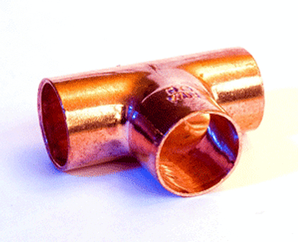

Many architects and engineers ask if copper-containing steels can be galvanized. They may have heard galvanizing copper-containing steels can damage galvanizing kettles. In most cases, this is untrue as there is only concern for kettle damage when the copper level in the kettle exceeds 0.23%.
Though copper usually does not cause any problems in the galvanizing kettle, there are some practical limitations when choosing materials for galvanizing. Pure copper cannot be galvanized because there is no iron for the zinc to metallurgically react with. Without a metallurgical reaction, a galvanized coating cannot develop.
Some steel chemistries with small amounts of copper can be successfully galvanized. One example of a copper-containing steel that can be galvanized is weathering steel, which is actually galvanized quite frequently. The galvanized coating that develops on weathering steel tends to be thicker and darker than galvanized coatings on steel with recommended chemistry. Thicker and darker galvanized coatings are normal for steels containing copper.
