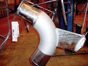

It is my understanding galvanizing process steps are similar for most items. Why is it some galvanized coatings have a dull, gray finish, while others have a bright, shiny finish? Also, which coating provides better corrosion protection?
It is true the galvanizing process is similar for most steel galvanized; however, there are several variables that affect the galvanizing process and determine product quality. These variables are steel chemistry, surface preparation, kettle chemistry, and steel exposure conditions during the galvanizing process.

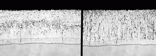

ASTM A123 acknowledges that silicon, phosphorus, and carbon content in steel affect the galvanized coating. ASTM A385 recommends limits and ranges for steel chemistry to ensure a high quality galvanized coating. The galvanized coating of steel with the recommended chemistry - non-reactive steel - will have a coating similar to the magnified coating in Figure 1. This coating has four distinct layers. The gamma, delta, and zeta layers are intermetallic alloy layers, and are harder than the base steel. The alloy layers give galvanized steel its outstanding abrasion resistance. The eta layer is the same composition as the zinc in the galvanizing kettle. The eta layer is responsible for the bright shiny appearance. Steel with chemistry outside the recommended limits and ranges for galvanizing is known as reactive steel.
A micrograph of a galvanized coating on reactive steel is shown in Figure 2. This coating has a very thin eta layer, although some reactive steels have no free zinc layer. Reactive steel has intermetallic alloy layers in the same order as non-reactive steel. However, the zeta layer in reactive steel is overgrown and tends to compose most of the galvanized coating thickness. Intermetallic layers do not have a bright shiny finish, and when exposed, appear dull gray. Galvanized coatings on reactive steels can be much thicker (over 10 mils) than coatings on non-reactive steel. The galvanized coating is created through a metallurgical reaction between iron in the steel and zinc in the galvanizing kettle.
This reaction is a diffusion reaction and increases with increased exposure time or temperature. Silicon and phosphorus in the steel serve as catalysts during this reaction. For non-reactive steel, the metallurgical reaction is complete within six or seven minutes. Increasing exposure time has little effect on the coating thickness for non-reactive steel. For reactive steel, the coating experiences linear growth with respect to increased exposure time in the galvanizing kettle. This means the longer reactive steel is left in the kettle the thicker the coating will be. The coating layer that experiences the most growth from increased exposure time is the zeta layer, which grows in long vertical columns toward the coating surface. Kettle chemistry can affect the quality of the galvanized coating. Galvanizers add small amounts of aluminum to the zinc to increase coating brightness.
