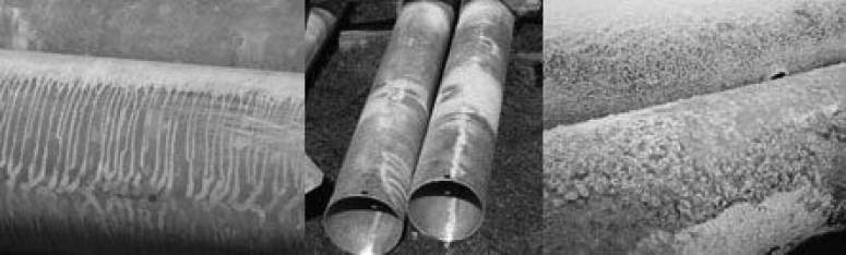

Wet storage stain is a white, powdery surface deposit on freshly galvanized surfaces. It can occur when newly galvanized surfaces are exposed to fresh water, such as rain, dew, or condensation and have no air flow over the surface causing zinc oxide and zinc hydroxide to form. Wet storage stain is found most often on tightly stacked and bundled items, such as galvanized sheets, plates, angles, bars, and pipes. Wet storage stain can have the appearance of light, medium, or heavy white powder on the galvanized steel product (Figure 51).
One method to avoid wet storage stains is to passivate the product after galvanizing by using a chromate quench solution. Another precaution is to avoid stacking products in poorly ventilated, damp conditions. Light or medium wet storage stain will weather over time in service and is acceptable. In most cases, wet storage stain does not indicate serious degradation of the zinc coating, nor does it necessarily imply any likely reduction in the expected life of the product. However, heavy wet storage stain should be removed mechanically or with appropriate chemical treatments before the galvanized part is put into service. Heavy storage stain must be removed or the part must be rejected and regalvanized.
The galvanizer is responsible for following best practices for avoiding wet storage stain on parts stored at the galvanizing facility. When those best practices are followed, the galvanizer is not responsible for wet storage stain developed at his facility, during transit, or storage at the job site prior to use. For more information on avoiding and/or removing wet storage stain, please see the AGA's publication Wet Storage Stain.
