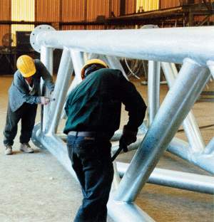

Field Repair
The zinc coating of hot-dip galvanized steel is difficult to damage, and field fabrication that requires removal of the coating should be minimized as much as possible. However, sometimes due to improper handling or abrasion after years in service, small voids are found in the coating. To maintain uniform barrier and cathodic protection and ensure longevity, it is best practice to touch-up and repair the coating. When it comes to touching-up galvanized steel in the field, there is no limitation to the size that can be repaired.
Repair Methods
Any repairs made to galvanized products must follow the requirements of ASTM A780 Practice for Repair of Damaged and Uncoated Areas of Hot-Dip Galvanized Coatings, which defines the acceptable materials and the required procedures. Repairs are normally completed by the galvanizer before the products are delivered, but under certain circumstances, the purchaser may perform the repairs on their own. The touch-up and repair materials are formulated to deliver similar colors to brightly coated, newly galvanized products or matte gray, aged galvanized products. Materials used to repair hot-dip galvanized products include zinc-based solder, zinc-rich paint, and zinc spray metallizing, and are explained in the following sections.
