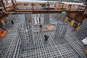

The specification ASTM A767/A767M is applicable exclusively to the hot-dip galvanizing of reinforcing steel, otherwise known as rebar (Figure 13), and is applicable to all types of rebar, both smooth and deformed. However, wire is not included.
The requirements in ASTM A767/A767M are also intended to produce a high quality zinc coating for corrosion protection.
