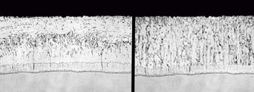

Figure 18 shows the difference in alloy formation on steel with the recommended silicon ranges (left) and those of reactive steels (right). The photomicrograph clearly shows the microscopic level differences that can occur due to the amount of silicon in the steel being hot-dip galvanized.

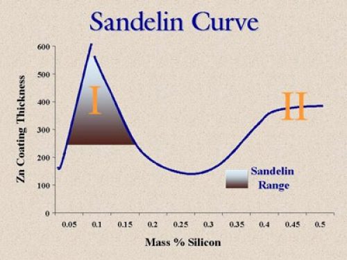

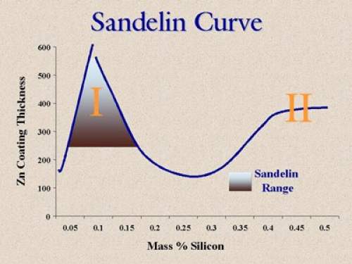

The Sandelin curve, as seen in Figure 19, compares the zinc coating thickness to the mass percentage of silicon in the steel. The range on the graph labeled "I" is called the Sandelin range, named after the metallurgist who discovered the behavior, and the coatings tend to be thick and dull gray as a direct result of the percentage of silicon present in the base steel. The Sandelin range is roughly between 0.05% and 0.15% silicon. The rangeon the graph labeled "II", which represents a steel content of greater than 0.25% silicon, shows the coating thickness increases with increased silicon content and then starts to level off at around 0.40% silicon.

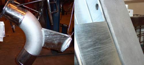

Figure 21 is an example of products with separate galvanized pieces that have very different appearances due to the difference in steel chemistry. This is often observed when connecting different types or thicknesses of steel, but can also occur on similar pieces. Another common place this is found is in welded areas, as the silicon content of the weld rod can influence appearance. Regardless of the appearance, all of these products have an equal amount of corrosion resistance and meet the specification requirements.

Cooling Rate
A steel part with both dull and shiny coating can also be the result of a different cooling rate. In Figure 22, the outer edges were cooled rapidly, which allowed free zinc or an eta layer to form on top of the intermetallic layers. The zinc in the center of the product remained above 550 F longer, thus the metallurgical reaction between zinc and iron continued consuming the free zinc layer, which gives the matte gray look. Eventually, as the product weathers, the differences in appearance will become less noticeable and/or disappear and the piece will become a uniform, matte gray throughout.
