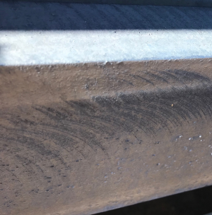

Fish Boning
Fish boning is an irregular pattern over the entire surface of the steel part. This is caused by differences in the surface chemistry of a large diameter steel piece and variations in the reaction rate between the iron in the steel and the molten zinc. These reaction differences cause the thickness of the galvanized coating to vary in sharply defined zones across the surface. Fish boning (Figure 34) has no effect on the corrosion protection provided by the zinc coating and is not cause for rejection of the hot-dip galvanized part.

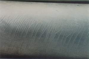

Oxide Lines
Oxide lines are light colored film lines on the galvanized steel surface created when a product is not withdrawn from the galvanizing kettle at a constant rate (Figure 38). This may be due to the shape of the product or the drainage conditions. Oxide lines will fade over time as the entire zinc surface oxidizes (weathers). Strictly an aesthetic condition, oxide lines have no effect on the corrosion performance; and therefore, are not a cause for rejection of the hot-dip galvanized parts.
