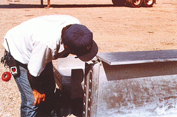

Inspection of hot-dip galvanized steel products does not end once they are accepted at the galvanizer's facility or job site. During the erection process, and once in place, any good corrosion protection strategy includes periodic inspection and maintenance to ensure the protective coating is performing as expected. When inspecting hot-dip galvanized steel in the field, the inspector should be aware of potential accelerated corrosion areas and aesthetic surface conditions and whether they are a concern.
When inspecting a galvanized coating in the field, the number one concern is the number of years remaining before the coating will need to be touched-up or replaced. Fortunately, estimating the remaining time to first maintenance for hot-dip galvanized coatings in atmospheric exposures is relatively simple. For a ballpark estimation, use a magnetic thickness gauge to take a coating thickness measurement and check the thickness value against the AGA's Time to First Maintenance Chart shown earlier in the course.

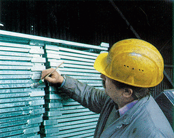

Visual Observations
In addition to taking coating thickness measurements, the galvanized coating can be visually inspected for signs of accelerated corrosion in specific areas. Thickness measurements should be taken in these areas to ensure adequate zinc coating remains or if touch-up should be performed.

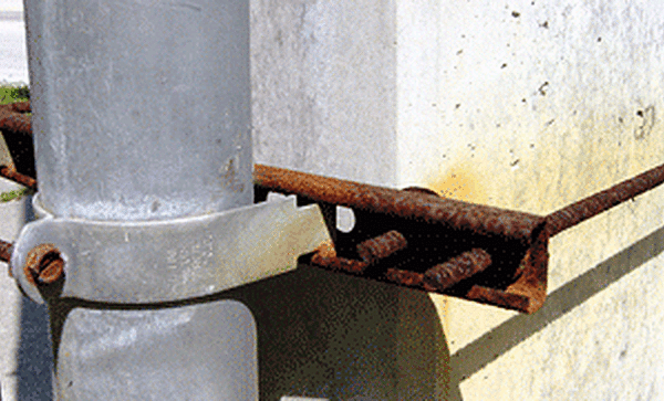

Dissimilar Metals in Contact
When dissimilar metals are in contact, galvanic corrosion can occur. Zinc, which comprises the galvanized coating, is high on the Galvanic Series of Metals; and therefore, will preferentially corrode to almost any other metal with which it is in contact. When possible, preventing dissimilar metals from being in contact should be addressed during the design process. Electrically isolating dissimilar metals from one another stops galvanic corrosion and can be accomplished by using plastic or rubber grommets between the dissimilar metals or by painting the cathode. When the surface area of the cathode is much larger than the anode, galvanic corrosion can quickly consume the anodic material.

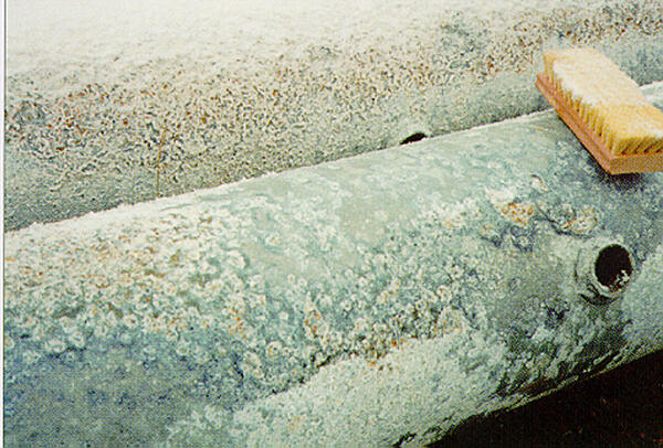

Wet Storage Stain
As addressed earlier in this publication, improper storage and tight stacking of galvanized products can lead to the development of wet storage stain or zinc oxide and hydroxide build-up on the surface, as discussed previously. If galvanized products are going to be stored before erection, it is important to properly vent the bundle to avoid the development of wet storage stain. For more information, see the AGA's publication Wet Storage Stain. Similar to the development of wet storage stain when storing materials, galvanized products in place that have moisture on the surface without the movement of free-flowing air can develop oxides and hydroxides that look like wet storage stain. A common area for this to occur is on surfaces where snow is piled on the surface and left to melt or in areas where water pools for extended periods without drying. Wet storage stain occurs most often during the first month after galvanizing.

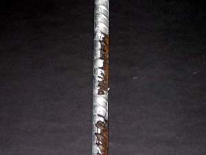

Weeping Welds
Weeping welds were previously discussed in this course, and though they can be seen immediately after galvanizing, often they occur after the steel is in service. As reviewed earlier, weeping welds are mostly a cosmetic concern; however, corrosion can be accelerated in the area where the liquids and rust bleeding are leaking. To clean and seal weeping welds, you can wash away the oxides on the outer area and apply epoxy or caulk to the area to prevent water from penetrating the crevices in the future.
