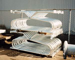

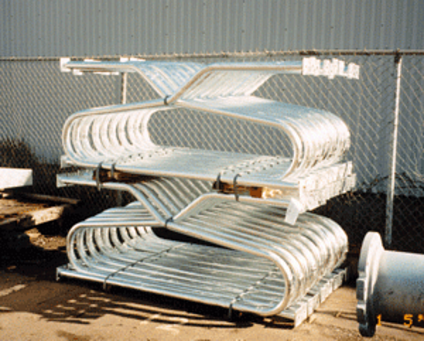

Peeling and flaking that occurs to the coating when bending rebar after galvanizing is not a cause for rejection and may be repaired. Bend tests on steel fabrications are strictly to test for embrittlement. The recommended bend radius is 3x the section thickness. There are various tests used to assess the ductility of steel when subjected to bending. One test may include the determination of the minimum radius or diameter required to make a satisfactory bend. Another test may include the number of repeated bends the material can withstand without failure when it is bent through a given angle and over a definite radius.
Rebar is commonly bent prior to the hot-dip galvanizing process. Steel reinforcing bars bent cold prior to hot-dip galvanizing should be fabricated to a bend diameter equal to or greater than the specified value in ASTM A767/A767M. However, steel reinforcing bars can be bent to diameters tighter than the specified values if they are stress relieved at a temperature of 900 to 1050 F (480 to 560 C) for one hour per inch (25 mm) of diameter.
