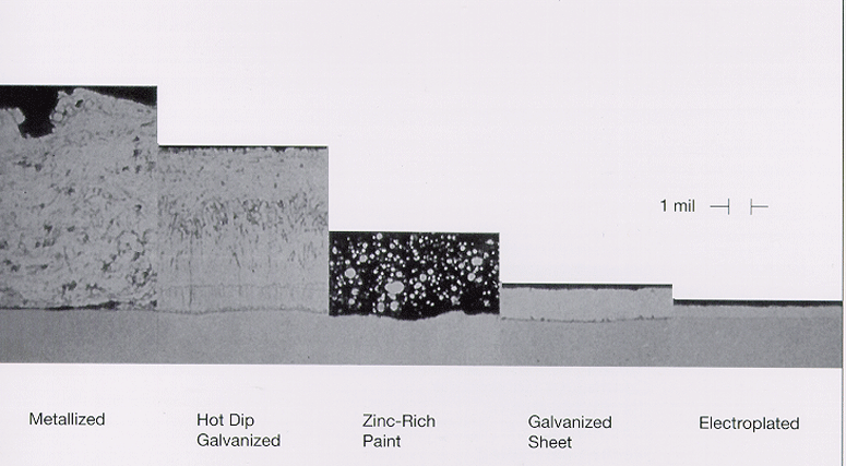

In addition to the systems and materials listed above, there are a wide variety of other zinc coatings used for corrosion protection. Many people use galvanizing to describe all of these coatings, but each has its own unique characteristics and performance. These coatings have several applications based on their properties and respective thicknesses. The corrosion protection offered by a zinc coating is directly linear to the coating thickness. The most commonly used coatings are hot-dip galvanized, metallized, zinc-rich paint, continuous galvanized sheet, and electroplated. The relative thickness for each of these zinc coatings can be seen in the photomicrograph (Figure 8). Below is a brief explanation of each type of zinc coating

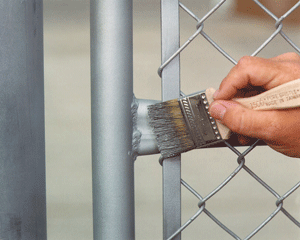

Zinc-rich paint is applied to a clean, dry steel surface by either a brush or spray and contains an organic or inorganic binder. There are a number of zinc-rich paints, as they can contain varying levels of zinc in dry film and binding materials. These coatings will be discussed in more detail later in this course.

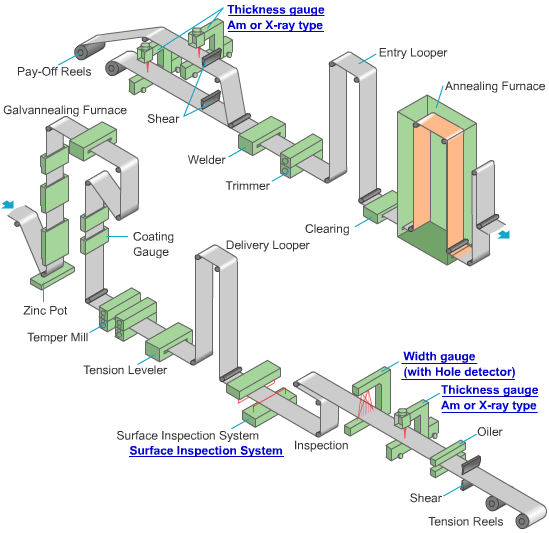

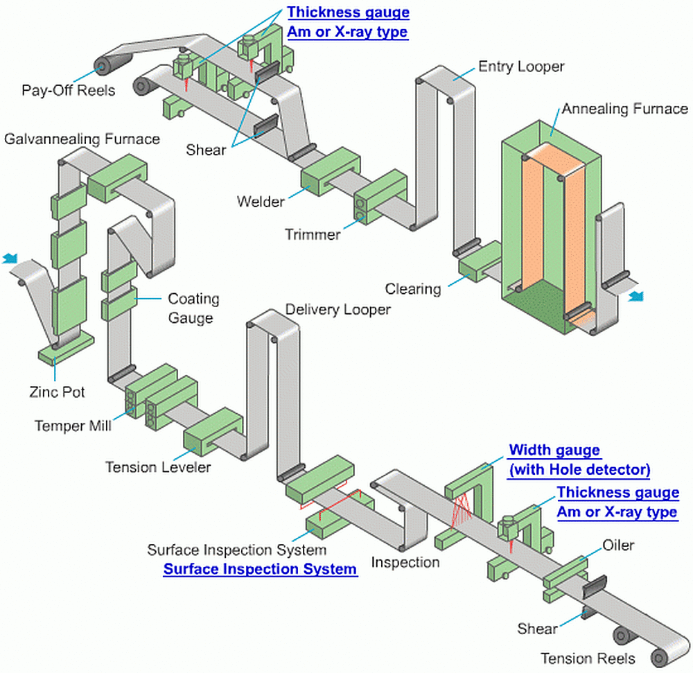

The continuous galvanizing process is a hot-dip process where steel sheet, strip, or wire is cleaned, pickled, and fluxed on a processing line approximately 500 feet (154 m) in length, and running at speeds between 100 to 600 feet per minute (30 to 185 m per minute). In this process, the galvanizing kettle contains a small amount of aluminum, which suppresses the formation of the zinc-iron alloys, resulting in a coating that is mostly pure zinc. A post-galvanizing, in-line heat treatment process known as galvannealing can also be used to produce a fully alloyed coating. Galvannealing is usually ordered by those wanting to paint over the zinc surface because the presence of alloy layers on the steel surface promotes paint adhesion. A photo of a continuous galvanizing plant is seen in Figure 9 and the common plant setup is shown in Figure 10.
