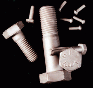

The specification ASTM A153/A153M applies to hardware products such as castings, fasteners, rolled, pressed, and forged products, and miscellaneous threaded objects that will be centrifuged, spun, or otherwise handled to remove excess zinc (Figure 12).
The requirements for ASTM A153/A153M are very similar to those stated earlier for ASTM A123/A123M, except for the addition of threaded products and embrittlement requirements.
