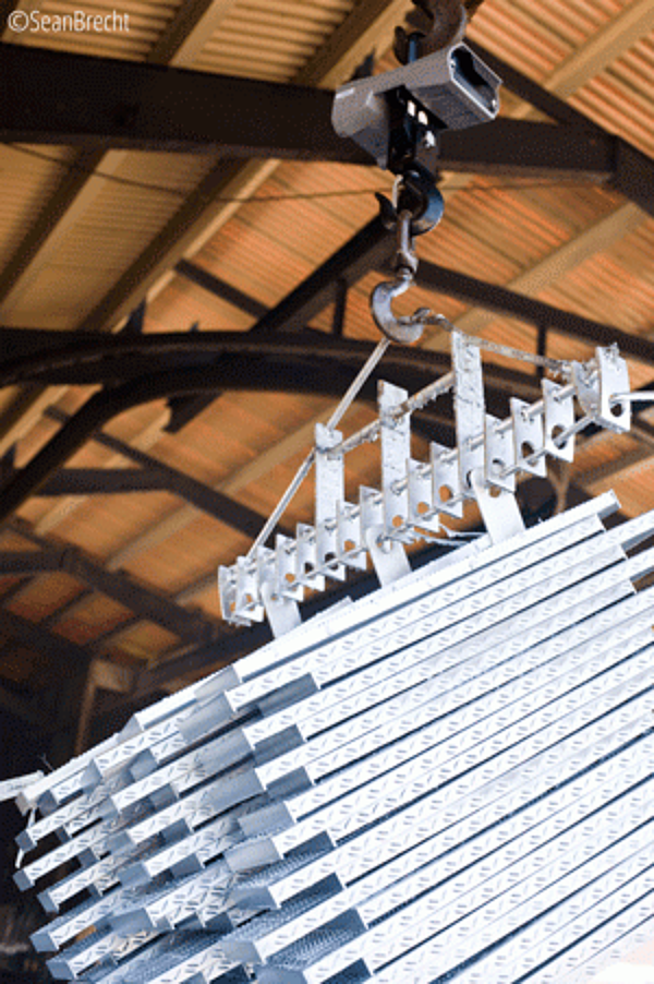

The purpose of surface preparation in the hot-dip galvanizing process is to obtain the cleanest possible steel surface by removing all of the oxides and other contaminating residues. Thorough surface preparation is paramount as zinc will not react with unclean steel. In order to move the steel parts through the cleaning steps and galvanizing bath, the articles are hung using chains, wires, or specially designed dipping racks (Figure 3).
