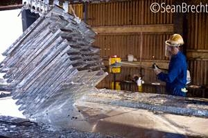

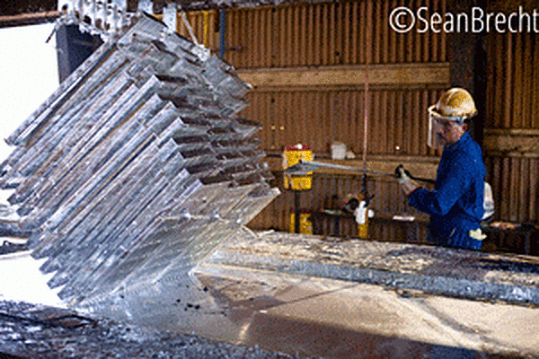

![Specifications for hot-dip galvanizing](/uploads/default/_600xAUTO_crop_center-center_75_none/SeanBrecht_199.gif)
There are certain specifications that have been developed for hot-dip galvanizing in order to produce a high-quality coating. There are three main standards that govern hot-dip galvanized steel, and a handful of supporting specifications that design engineers and fabricators should become familiar with to promote a high-quality coating and ensure their steel design is suitable for hot-dip galvanizing.
