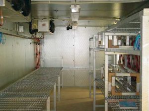

Oftentimes, food is stored in containers made of plastic or other materials, so direct contact between food and galvanized steel never occurs. In these situations, galvanized steel is a very suitable application. Documented applications of this include bread cooling racks and pallet racks in a freezer. Galvanized steel has also been used as a coating for countertops in restaurants and bars in Europe and the United States.
