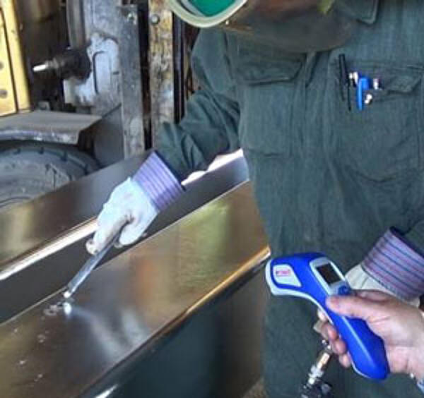

Zinc-Based Solders
Soldering with zinc-based alloys is achieved by applying zinc alloy in either a stick or powder form. The area being repaired needs to be preheated to approximately 600 F (315 C). The acceptable material compositions of solders used for repair are included in the specification. The final coating thickness for this repair shall meet the specification requirement for the material category of the steel part being repaired with a maximum thickness of 4 mils (100 µm). The thickness shall be measured by any of the methods in A123/A123M that are nondestructive. Zinc-based solder products closely match the surrounding zinc and blend in well with the existing coating appearance.

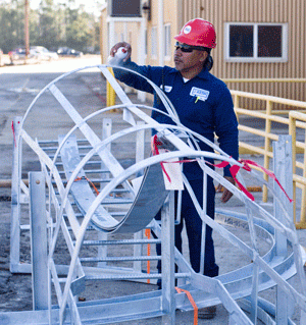

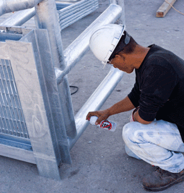

Zinc-Rich Paints
Zinc-rich paint is applied to a clean, dry steel surface by either a brush or spray. Zinc-rich paints must contain either between 65% to 69% metallic zinc by weight or greater than 92% metallic zinc by weight in the dry film. Paints containing zinc dust are classified as organic or inorganic, depending on the binder they contain. Inorganic binders are particularly suitable for paints applied in touch-up applications of undamaged hot-dip galvanized areas. The coating thickness for the paint must be 50% more than the surrounding coating thickness, but not greater than 4.0 mils (100 µm), and measurements should be taken with either a magnetic, electromagnetic, or eddy current gauge to ensure compliance.

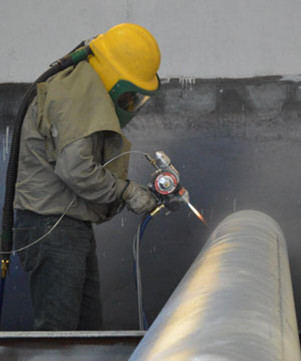

Zinc Spray (Metallizing)
Zinc spray metallizing is done by melting zinc powder or zinc wire in a flame or electric arc and projecting the molten zinc droplets by air or gas onto the surface to be coated. The zinc used is nominally 99.5% pure or better. The renovated area shall have a zinc coating thickness at least as thick as that required in ASTM A 123/A 123M for the material category. For best results, thickness measurements for the metallized coating should be taken with either a magnetic or an electromagnetic gauge.
