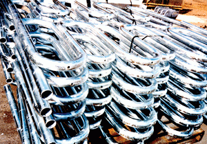

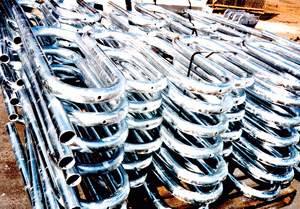

Cold Working Steel
Bike Rack
Many structures and parts are fabricated using cold-rolled steel or cold-working techniques. In some instances, severe cold-working may lead to the steel becoming strain-age embrittled. While cold working increases the possibility of strain-age embrittlement, it may not be evident until after galvanizing. This occurs because aging is relatively slow at ambient temperatures, but more rapid at the elevated temperature of the galvanizing bath. Any form of cold-working reduces steels ductility. Operations such as punching holes, notching, producing fillets of small radii, shearing, or sharp bending may lead to strain-age embrittlement of susceptible steels. Cold-worked steels less than 1/8" (3 mm) thick that are subsequently galvanized are unlikely to experience strain-age embrittlement. Cold working is the strongest contributing factor to the embrittlement of galvanized steel.

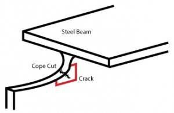

Cope Cuts
Flame cut copes on beams can be extremely sensitive to residual stresses in the steel and the surface of the cut can be rough. Both of these factors can contribute to cracks forming in the cut edges. The potential for cracking can be significantly reduced by thermal conditioning the cut edge. Weld bead should be applied in the highlighted area on both sides of the copes. A simple technique for accomplishing this is to apply a weld bead along the cut edge, thereby reducing residual stresses and avoiding cracking.
Cope cuts
There is still a small potential for cracking on these cut edges as well as on the corners of HSS rectangular tubing. The two areas should be visually inspected after galvanizing to detect the presence of any cracks. Any cracks can be repaired by removing steel around the crack, filling the area with weld material, smoothing the weld and then applying a zinc coating per ASTM A780 Practice for Repair of Damaged and Uncoated Areas of Hot-Dip Galvanized Coatings before the steel is delivered.

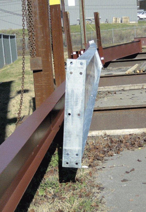

Heating and Cooling Rates
Heating Cooling Rates
Steel that is being galvanized is exposed to a wide temperature range from ambient to 850 F. Because parts are immersed at an angle, uneven heating and cooling occur. This exposure to temperature variations allows the steels internal stresses to be relieved at different times. Some fabricated assemblies may distort at galvanizing temperature as a result of relieving stresses induced during steel production and in subsequent fabricating operations. For example, a channel frame with a plate should be galvanized separately and bolted later rather than welded together before galvanizing, or it can be welded after galvanizing. Guidelines for minimizing distortion and warpage are provided in ASTM A384, Safeguarding Against Warpage and Distortion During Hot-Dip Galvanizing of Steel Assemblies, and CSA SpecificationG164, Hot Dip Galvanizing of Irregularly Shaped Articles.

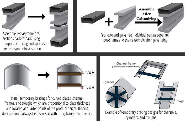

Asymmetrical Designs
  • Specify symmetrically rolled sections instead of angle or channel frames.
  • Assemble two asymmetrical sections back-to-back using temporary bracing and spacers to create a symmetrical section.
  • Install temporary bracings for curved plates, channel frames, and troughs which are proportional to plate thickness; located at quarter points of product height.
  • Tees should be dipped flange-side first while channels should be dipped web-side first.
  • Perform immersion as quick as possible and at the largest possible dip angle.

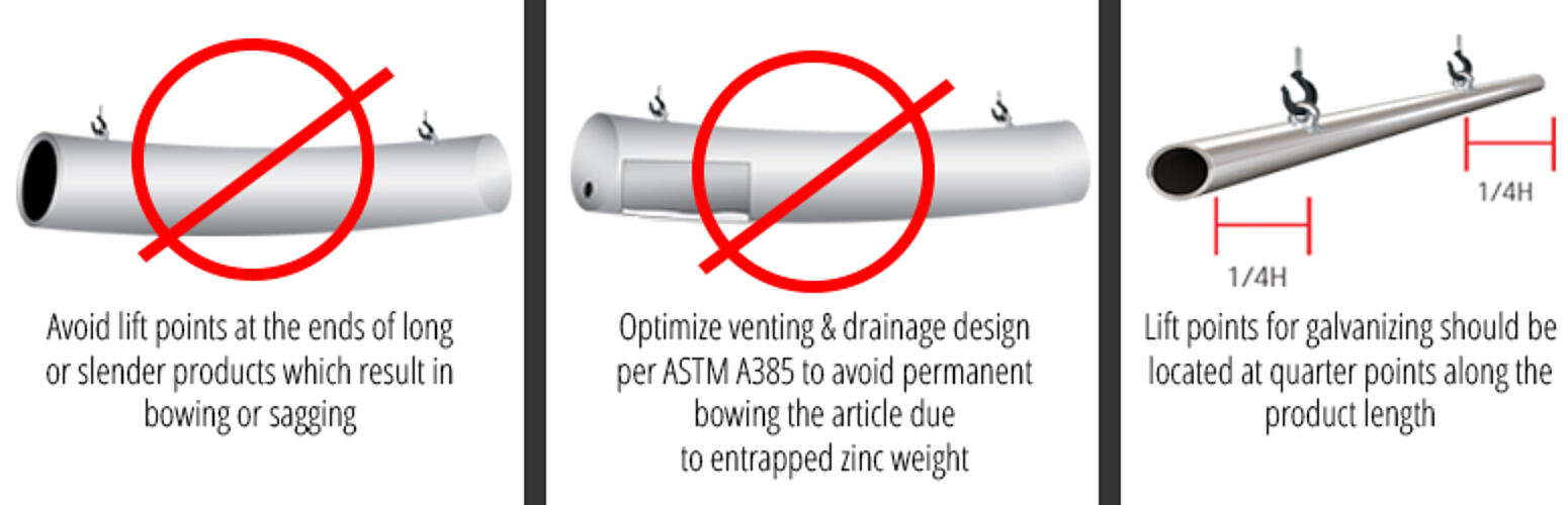

Poor Drainage/Venting and Lifting Points
  • Lift points for galvanizing should be located at quarter points along the product length.
  • Design drainage/venting holes per ASTM A385 and maximize drainage for hollow sections.
