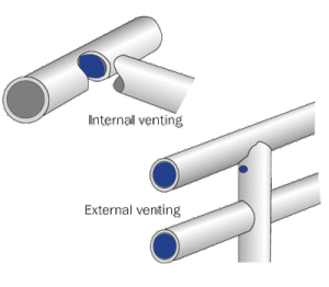

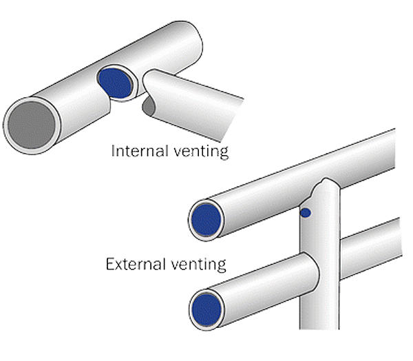

For effective galvanizing, cleaning solutions and molten zinc must flow without undue resistance into, over, through, and out of the fabricated article. Failure to provide for this free, unimpeded flow can result in complications for the galvanizer and the customer. Improper venting and drainage design results in poor appearance, bare spots, and excessive build-up of zinc. All of these are unnecessary and costly, and another example of why communication throughout the project is key. To provide an optimal galvanized coating, proper cleaning, venting, and draining are important.
The primary reason for vent and drain holes is to allow air to be evacuated, permitting the object to be completely immersed into cleaning solutions and molten zinc. Proper hole sizing and location make it safer to galvanize and provide the optimal finish. The secondary reason is to prevent damage to the parts. Any pickling solutions or rinse waters that might be trapped in a blind or closed joining connection will be converted to superheated steam or gas and can develop a pressure of up to 3,600 psi (25 MPa) when immersed in molten zinc. Not only is there risk of damage to the fabrication being galvanized, but there also is risk of serious hazard to galvanizing personnel and equipment.
