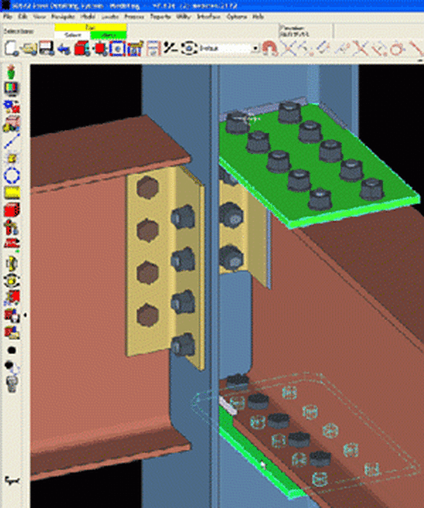

Design Data Detail Software
To aid in the communication process and ensure galvanizers receive steel fabricated with proper details, the AGA has been working with Design Data, a steel detailing software company. Design Data has now incorporated galvanizing details into their software program SDS/2. SDS/2 now allows the user to designate their fabriation will be hot-dip galvanized so the software can assist with proper design. The user can either designate hot-dip galvanizing at set up, as each member is designed, or after the design is complete. A few examples of what the software will facilitate when galvanizing is selected:
- Automated vent/drain locations and sizes
- Checks for kettle size fit, dissimilar materials, vents/drains, welds
- Defaults to American Institute of Construction (AISC) Standards
