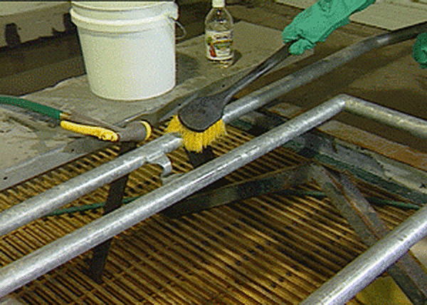

Cleaning the Surface
The first step for both coatings is to clean the surface. There are two clean-up steps, first removing bumps, runs, drips - which newly galvanized and partially weathered surfaces require whether painting or powder coating. Fully weathered coatings would not require this, because it has already been in service and therefore these issues should not exist. Second, the parts must be cleaned to remove organic materials, rinsed and dried. Whether painting or powder coating, partially and fully weathered surfaces would need this step, while newly galvanized does not as there should be little on the surface at that time. There are a number of acceptable cleaning compounds to remove organic materials which are detailed in the specifications.
