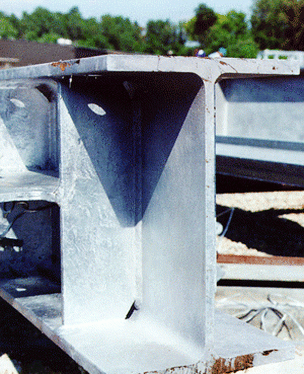

ASTM A385: Practice for Providing High-Quality Zinc Coatings (Hot-Dip)
This specification has details on steel selection and other design practices such as venting/draining, welding, etc. to ensure the best quality product after galvanizing.

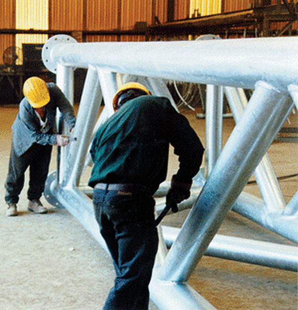

Post-Galvanizing Supporting Specifications
ASTM A780: Practice for Repair of Damaged and Uncoated Areas of Hot-Dip Galvanized Coatings
This specification details the accepted forms of touch-up and repair for galvanizing whether done at the galvanizers facility or by the designer/contractor in the field during erection.
