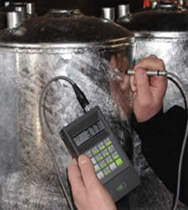

Coating Thickness
Coating thickness refers to the thickness of the final hot-dip galvanized coating. Two different methods are used to measure the coating thickness of hot-dip galvanized steel; a magnetic thickness gauge and optical microscopy. Utilizing a magnetic thickness gauge is a non-destructive, simple way to measure coating thickness.
A sampling protocol has been adopted by ASTM to ensure high quality products because the inspection of the coating thickness for every piece of material galvanized in a project would not be practical. To properly evaluate hot-dip galvanized coatings, randomly chosen specimens are selected to represent the lot. The inspection quantities are determined by the lot sizes and are detailed in the ASTM specifications A123/A123M, A153/A153M, and A767/A767M. For products whose surface area is equal to or less than 160 in2 (1032 cm2), the entire surface of the tested product constitutes a single specimen. Products containing multiple material categories or steel thickness ranges and products with surface areas greater than 160 in2 (1032 cm2) are considered multi-specimen products.
The specifications contain detailed information, but a couple of universal practices are recognized:
- At least five widely dispersed measurements must be performed per specimen
- Average for each specimen should not be less than one thickness grade lower than material category
