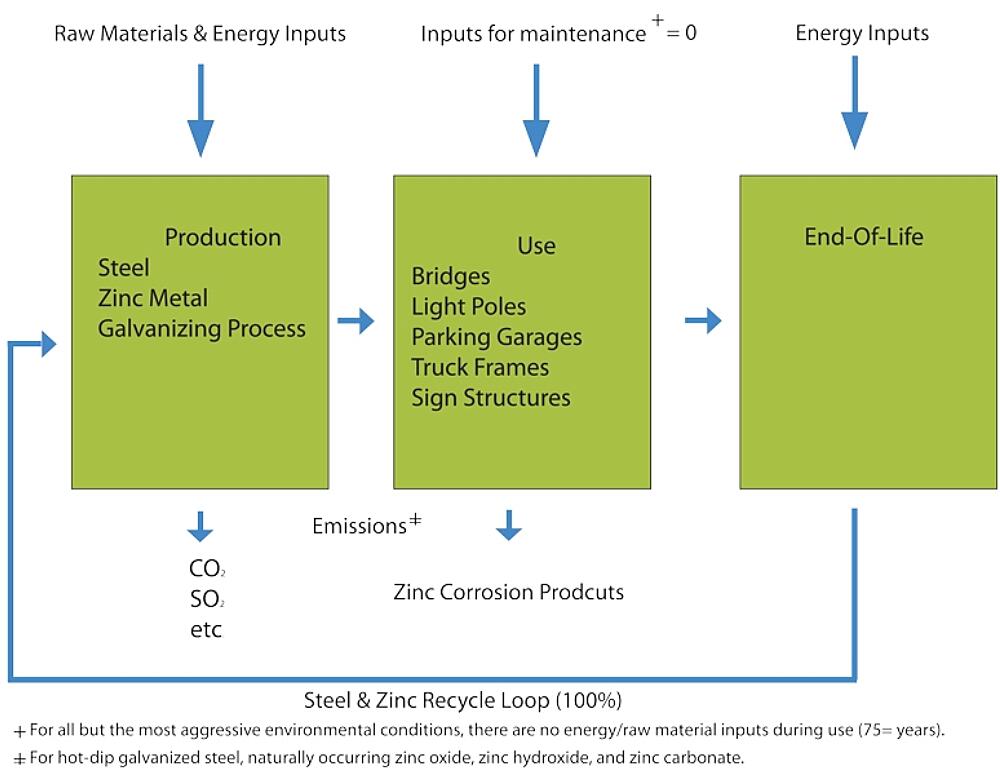

In 2008, the International Zinc Association (IZA) hired internationally renowned LCA experts Five Winds International and PE International to conduct a life-cycle inventory (LCI) and life-cycle assessment (LCA) for hot-dip galvanized steel. Utilizing data from worldwide sources regarding energy consumption and air/fluid/solid emissions measured during zinc production and during the actual galvanizing process, combined with analogous survey data collected from the steel industry, an LCA for hot-dip galvanized steel was compiled. The graphic below shows an overview of the impact of hot-dip galvanized steel from production to end-of-life.
![Life Cycle Assessment of HDG](/uploads/default/_1000xAUTO_crop_center-center_75_none/LCA.jpg)
Hot-dip galvanizing is unique in that all material and energy inputs and emission outputs are isolated to the production phase, as there is no maintenance required for 70 years or more in most environments. The following pages will examine each of the phases (production, use, and end-of-life) in more detail.
