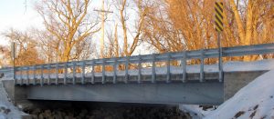

Life-Cycle Cost Case Study
To examine the initial and life-cycle costs of using galvanized steel, lets take a look at a hypothetical structural steel bridge project developed using realistic parameters. By using the Life-Cycle Cost Calculator, one can see how galvanized steel will provide an 83% cost savings for the bridge.
The cost data used in the online calculator comes from two sources. The paint data comes from a nationwide survey of paint manufacturers conducted by KTA Tator, a consulting firm specializing in protective coatings, in 2008. The galvanizing data was obtained from a 2011 survey of North American hot-dip galvanizers. Here are the parameters for the Einstein Bridge project:
- Project Size: 1,200 tons
- Structure Type: Simple 50-100 high
- Service Life Environment: Industrial
- Design Life 80-Years
- Member Type: Medium Structural
- Paint System: IOZ/Epoxy/Polyurethane. SP-6 Automated surface prep. and 9 mil minimum DFT.
- Inflation: 3%
- Interest: 2%
Initial Cost
As mentioned before, it is not recommended to analyze only the initial cost for a corrosion protection system. However, if it is the only analysis, galvanizing is still a solid choice in this analysis. As is common, projects with many smaller components and structural steel will yield an initial galvanizing cost lower than most paint systems, as the galvanizing process efficiently accommodates bundles and groups of steel.
Coating System | Initial Cost | |
$/ft2 | Total | |
Hot-Dip Galvanizing | $2.20 | $528,000 |
IOZ/Epoxy/Polyurethane | $3.87 | $927,720 |
Life-Cycle Cost
While the initial cost was competitive, lets now look at the life-cycle cost which is where you really see the savings. Based on the Einstein Bridge example, the life-cycle cost of galvanizing vs. the paint system are as follows:
$/ft2 | Total | |
Hot-Dip Galvanizing | $4.61 | $1,106,400 |
Paint System | $52.24 | $12,537,600 |
The cost savings for utilizing hot-dip galvanzing is 88% over the 80-year life of the bridge.
