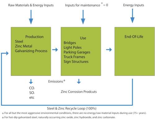

A more objective and complete measurement of the sustainability of a product is a life-cycle assessment (LCA). LCA, often called a "cradle-to-grave" study, is the study of the environmental impact of a process or product from raw material acquisition, energy inputs and emission outputs during production and use, and end-of-life management (recycling/disposal).
In 2008, the International Zinc Association (IZA) hired internationally renowned LCA experts Five Winds International and PE International to conduct a life-cycle inventory (LCI) and life-cycle assessment (LCA) for hot-dip galvanized steel. Utilizing data from worldwide sources regarding energy consumption and air/fluid/solid emissions measured during zinc production and during the actual galvanizing process, combined with analogous survey data collected from the steel industry, an LCA for hot-dip galvanized steel was compiled. The graphic below shows an overview of the impact of hot-dip galvanized steel from production to end-of-life.
Hot-dip galvanizing is unique in that all material and energy inputs and emission outputs are isolated to the production phase, as there is no maintenance required for 70 years or more in most environments. The following pages will examine each of the phases (production, use, and end-of-life) in more detail.

Determining the environmental impact of a product starts with raw material acquisition and the amount of energy input and emission output during production. For hot-dip galvanizing (HDG), the production phase requires three life-cycle inventories (LCI) as the finished galvanized product cannot be created without first mining and producing the steel and zinc. Therefore, the production phase for HDG includes the life-cycle inventories of steel, zinc, and the galvanizing process.
Long before galvanized steel is erected as long-span steel bridge or used to construct elements of airport terminal, production begins on the steel and zinc metals. To begin, more than 95% of structural steel manufactured in North America is fully recycled from previously used steel materials, making the initial environmental impact of using a steel frame minimal. By specifying a hot-dip galvanized (HDG) zinc coating for corrosion protection, you are choosing to utilize yet another abundant, recyclable, natural metal to further the cause of sustainability as 30% of all zinc produced comes from recycled sources.
Combining the three LCIs of steel, zinc, and the galvanizing process provides the environmental impact of producing 1 kg of hot-dip galvanized steel, up to the point it leaves the galvanizer's facility. The production phase is the only phase where energy is used and waste is created because of galvanizing's long-term, maintenance-free corrosion protection, so the initial environmental cost is the final cost.
