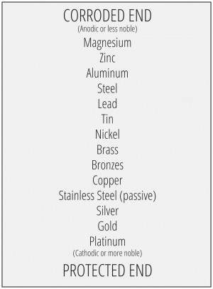

Cathodic Protection
In addition to barrier protection, hot-dip galvanizing protects steel cathodically, which means zinc will preferentially corrode to protect the underlying base steel.
The Galvanic Series of Metals (left) is a list of metals arranged in order of electrochemical activity in seawater (the electrolyte). This arrangement of metals determines what metal will be the anode and cathode when the two are put in an electrolytic cell. Metals higher on the list are anodic to the metals below them meaning they provide cathodic or sacrificial protection when the two are connected. Therefore, zinc protects steel.

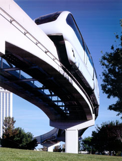

Galvanizings cathodic protection provides a second level of corrosion resistance for transportation infrastructure, especially for items along the highway and rail lines, as well as rail/bus stations. The sacrificial action of zinc means even if the coating is damaged by abrasive elements such as road debris, vehicle or bike contact, etc., no corrosion will begin until all of the surrounding zinc is consumed.
The natural cathodic protection of hot-dip galvanizing limits the need for maintenance of structures often constructed as install and forget it elements, which is important especially in mass transit where reliable service and safety is critical for the large volume of passengers.

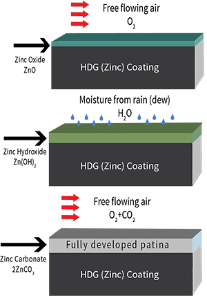

Zinc Patina
And the final factor in HDGs long-lasting corrosion protection is the development of the zinc patina. The zinc patina is the formation of zinc corrosion byproducts on the surface of the steel. Zinc, like all metals, begins to corrode when exposed to the atmosphere. As galvanized coatings are exposed to both moisture and free flowing air, corrosion byproducts will naturally form on the coating surface. The formation of these byproducts (zinc oxide, zinc hydroxide, and zinc carbonate) occurs during natural wet and dry cycles in the environment. The zinc patina, once fully developed, slows the corrosion rate of zinc to about 1/30th the rate of steel in the same environment and acts as an additional passive, impervious barrier for the hot-dip galvanized coating.
