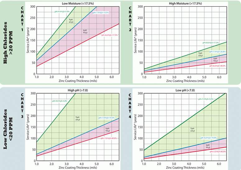

The AGA has developed a new chart for estimating HDG's performance in soil based on real-world corrosion data. Service life as defined by the chart is total consumption of the coating plus 25% and is an indication of when the structure should be replaced. There are four different charts based on the characteristics of the soil.
To use the chart, you must first classify the soil by chloride content. Charts 1 and 2 are used for soils with high chlorides (>20 PPM) and Charts 3 and 4 are used for soils with low chlorides (<20 PPM). Once you have identified the chloride content, there is a second classification to determine the correct chart to use. For soils with high chlorides, the second determination would be moisture content. Soils with low moisture (<17.5%) fall on Chart 1, while soils with high moisture (>17.5%) fall on Chart 2. For low chlorides, the second determination is the pH level. Soils with high pH levels (>7.0) fall on Chart 3, while soils with low pH (<7.0) fall on Chart 4.
The blue line on all four charts represents the average for soils surveyed in that characteristic group. The green line represents the best soil in the category sampled, and the red line represents the worst soil in the category of the study. The shaded areas show how the changes in pH and moisture content affect the estimated service life. Assuming 3.5 mils as a minimum thickness for HDG buried in soil, the chart shows the average life in the harshest soils (uncommon) would be approximately 30 years and in the best soils exceed 120 years.
