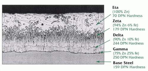

A unique characteristic of the hot-dip galvanized (HDG) coating is the development of tightly-bonded (3,600 psi), abrasion resistant intermetallic layers. This photomicrograph (below)  is a cross-section of a galvanized steel coating showing the three intermetallic layers (Gamma, Delta, and Zeta) and top layer of pure zinc (Eta). During the galvanizing process, these layers develop naturally during a metallurgical reaction between the iron in the steel and zinc in the kettle. The photomicrograph also notes the hardness of each of the layers as a Diamond Pyramid Number (DPN). As you can see, the three intermetallic layers are harder than the base steel, while the eta layer has ductility which makes damaging the HDG coating very difficult.

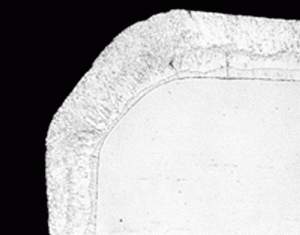

HDG coating grows perpendicular to all surfaces
HDG coating grows perpendicular to the surface
Hot-dip galvanizing is a total immersion process meaning the steel is fully submerged into cleaning solutions and the molten zinc coating all interior and exterior surfaces. This complete coverage ensures even the insides of hollow and tubular structures and the threads of fasteners are coated. As corrosion tends to occur at an increased rate on the inside of hollow structures where humidity and condensation occur, interior coverage is very beneficial. Hollow structures that are painted have no corrosion protection on the inside. Fully coating fasteners is equally important as they are utilized at connection points which are critical to structural integrity.

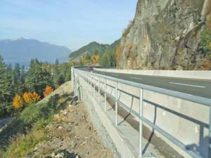

In addition to complete coverage, galvanized coatings also provide uniform coating thickness ensuring uniform corrosion protection throughout the piece, including vulnerable corners and edges. This is important when dealing with items such as baggage handling conveyors and pushers as well as handrail and bus/train station elements. Corners and edges of these items often have more potential for scratching or rubbing abrasion that would penetrate and weaken the already thinner areas of brush and spray applied coatings.
Hwy 99 guardrail
Hwy 99 guardrail
Complete, uniform coverage can benefit transportation infrastructure elements such as signage, electrical poles, handrails, etc. - made with hollow tubular materials which are protected inside and out by the consistent zinc coating. Protecting the entire fastener, including threads, along rail lines is critical to prevent maintenance repairs and keep tracks safe. Similarly, galvanized rebar is not allowed any voids in its coating, unlike epoxy-coated rebar, so there are no weak points when embedded in the concrete of bridges, runways, and other infrastructure.

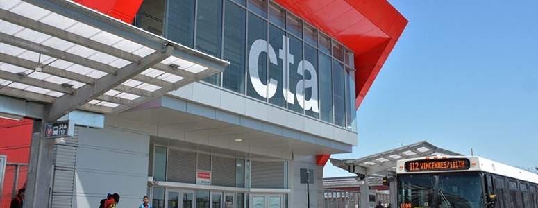

Chicago CTA's 95th Street Red Line Terminal - Chicago, IL, 2018
Cta
Partially covered in eye-popping red panels and largely enclosed by glass and galvanized steel, the new South Terminal rises above the Dan Ryan Expressway like a phoenix. The striking $280 million terminal features highly visible hot-dip galvanized canopy arms surrounding the entire facility and helps protect riders from the rain, snow, wind and biting cold of Chicago. The Chicago Transit Association’s (CTA) 95th/Dan Ryan station is a critical piece of the CTA's Red Line. It connects Far South Side communities to job centers throughout the region and serves as a transit gateway for the South Side and suburbs.
Early design considerations and the selection of hot-dip galvanizing (HDG) was strongly shaped by corrosion control over design life, ingenuity in use of galvanizing, final appearance and the strong visible zinc finish on the terminal canopy structure. Cost effectiveness of HDG was also paramount as this project required quick turn service from last minute design tweaks, and a demanding delivery schedule of trucks to the job-site to minimize road closures in the middle of the night.
