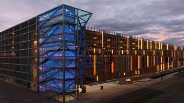

One of the primary advantages of utilizing hot-dip galvanized steel elements in anything from bridges to airport baggage carriers is the durable corrosion protection provided by a coating that will withstand the effects of time, damage, and weather. A combination of barrier and cathodic protection, in addition to the zinc patina, work together to protect exposed galvanized steel elements, allowing them to exist outdoors, maintenance-free for decades. Contrarily, alternatives such as concrete and painted steel are not equipped for the harsh conditions of constant exposure to weather and/or pedestrian and vehicle traffic.
Unlike hot-dip galvanizing which provides impervious protection to the steel, the pinholes in paint coatings and porous nature of concrete allow corrosion accelerating electrolytes to penetrate the material and attack the underlying or reinforcing steel within. This attack leads to cracking, peeling paint, and spalling, all of which require costly, regular maintenance throughout the life of the structure.
The maintenance-free protection of galvanized steel means big savings during the use phase.
