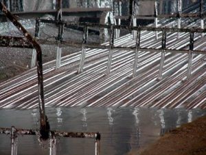

  1. Degreasing - A hot alkali solution, mild acidic bath, or biological cleaning bath removes organic contaminants such as dirt, paint markings, grease, and oil from the metal surface. Epoxies, vinyls, asphalt, or welding slag, which cannot be removed by degreasing, must be removed before galvanizing by grit-blasting, sand-blasting, or other mechanical means.
  2. Chemical Cleaning - A dilute solution of heated sulfuric acid or ambient hydrochloric acid removes mill scale and iron oxides (rust) from the steel surface. As an alternative to or in conjunction with chemical cleaning, this step can also be accomplished using abrasive cleaning or air blasting sand, metallic shot, or grit onto the steel.
  3. Fluxing - The final surface preparation step, a zinc ammonium chloride solution, serves two purposes. It removes any remaining oxides and deposits a protective layer on the steel to prevent any further oxides from forming on the surface prior to immersion in the molten zinc.

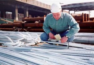

The inspection of hot-dip galvanized steel is simple and quick. The two properties of the hot-dip galvanized coating closely scrutinized are coating thickness and coating appearance. There are additional tests outlined for adherence, but these are typically only administered as a “referee” test, or when an issue is suspected.
Products are galvanized according to long established, accepted, and approved standards of ASTM, the International Standards Organization (ISO), the Canadian Standards Association (CSA), and the American Association of State Highway and Transportation Officials (AASHTO). These standards cover the minimum coating thicknesses required for various categories of galvanized items as well as finish/appearance, and adherence.
Testing methods and interpretation of results are covered in the publication, The Inspection of Products Hot-Dip Galvanized after Fabrication, as well as in our Online Inspection Course and free Inspection App. Links to all of these resources can be found on the AGA’s website. The majority of these resources is focused on visual inspection, as there are a variety of coating inconsistencies that can happen during galvanizing. The app, publication, and course examines what causes these various conditions and whether or not the acceptable according to the specifications.

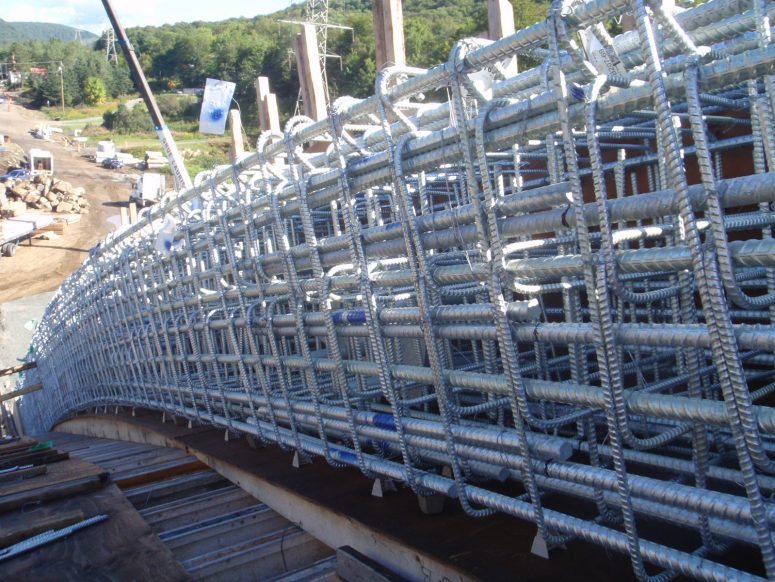

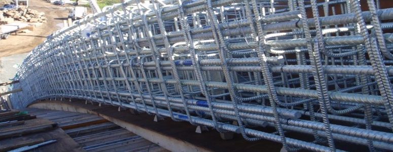

This suspended arch bridge is an aesthetically pleasing solution to a unique site requirement. The choice of hot-dip galvanized steel was preferred by the engineer because of its durability and cost compared to weathering steel in this highly corrosive environment. The resulting bridge is a beautiful and cost-effective marriage between structural steel and reinforced concrete.
The arched bridge design, unusual for a highway overpass, was chosen primarily to overcome two problems; uneven and rocky field conditions, as well as the very obtuse angle at which the road passed over the highway, which did not fit well with typical overpass construction. Steel beams were chosen for the deck because of the lower weight as compared to concrete. These beams were also designed to be galvanized rather than metallized, again, for economic and performance reasons. As for the reinforcing steel, the choice of hot-dip galvanizing was obvious since the concrete arches needed to be protected both structurally and aesthetically.
This type of bridge design, combining steel and concrete, is not often used. The unique design of this type of bridge makes it very interesting both architecturally and structurally. The use of galvanizing in all aspects of the bridge breaks new ground for our industry. Galvanized structural steel, galvanized reinforcing steel in the concrete, and even the supporting cables are galvanized (cables were supplied galvanized by the cable manufacturer).
