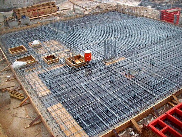

Because concrete is a porous material, corrosive elements will inevitably seep deep into the exposed concrete, eventually reaching the rebar within. If left unprotected, the steel will begin to rust, creating corrosion products 2-10 times more voluminous than the original steel. The volume of these corrosion products will begin to create stress that exceeds the tensile capacity of the surrounding concrete, causing it to crack and spall. This can be dangerous for the vehicles, pedestrians, or wildlife below, and can weaken and compromise the stability of the concrete structure. Hot-dip galvanized reinforcing steel eliminates the risk of spalling because the zinc corrosion products are less voluminous and migrate away from the bar into the matrix of the concrete. The migration alleviates the potential for increased pressure, thus eliminating the risk of spalling.

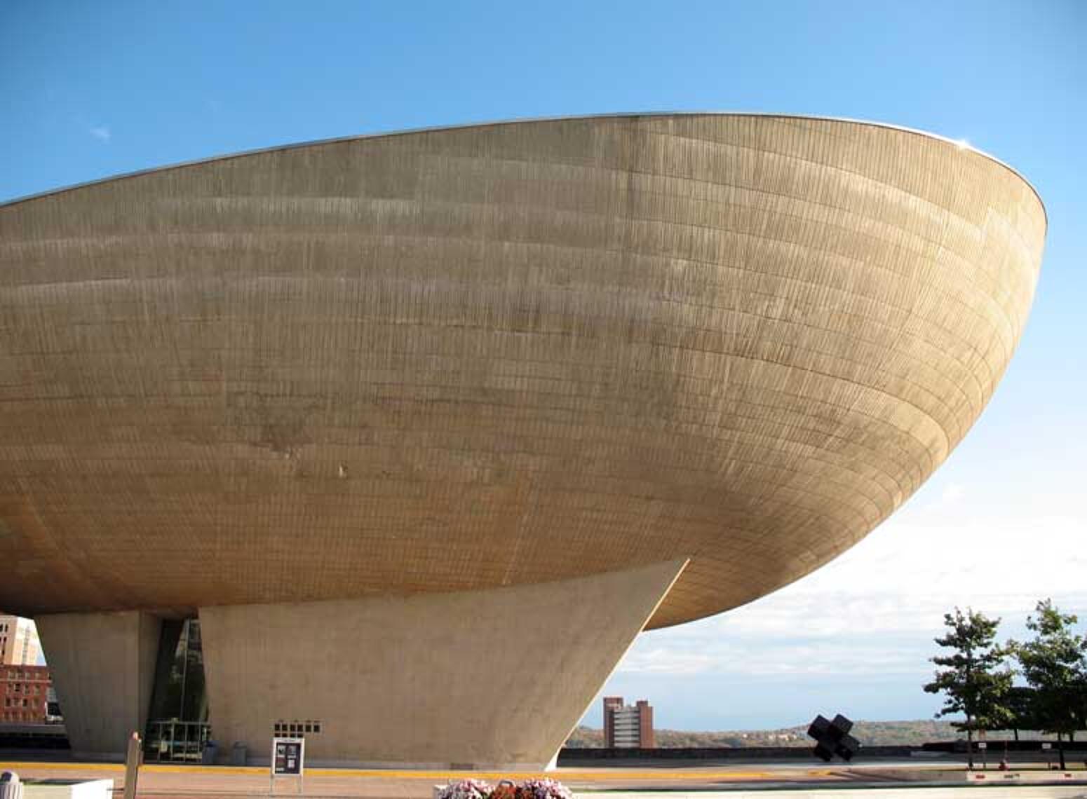

The Egg- Albany, NY, 1978
The Egg at the Empire Center Plaza in Albany, NY, was completed in 1978. The performing arts center was a massive undertaking of architecture, combining aesthetics and function in a concrete and steel form. The concrete and steel stem of the structure extends six stories into the ground. The Egg keeps its shape by wearing a girdle comprised of a heavily reinforced concrete beams utilizing hot-dip galvanized rebar.
The superior durability and corrosion protection of hot-dip galvanized steel made it the logical choice for the reinforcement of the concrete in such an integral factor of the structure's design. The reinforced girdle helps the egg keep its shape and directs the weight of the structure onto the supporting pedestal and stem. Housing two theaters, the building's curved exterior is continued on the interior. The walls are not square with harsh corners, but rather curve even up to meet the concave ceiling to give an appearance of endlessness and improved acoustics. Thanks to hot-dip galvanized reinforcing steel, The Egg's extravagant design has not only wowed citizens and visitors for decades, but it will remain a beautiful centerpiece of Albany for generations to come.
